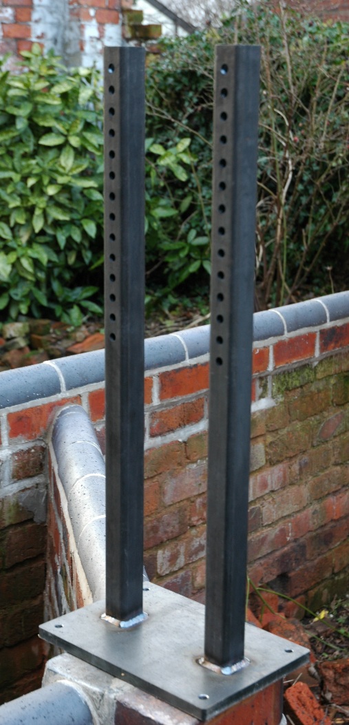

#4 Post by mangocrazy » Sat Jan 24, 2015 4:44 pm

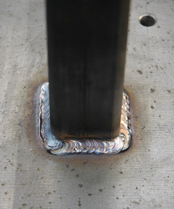

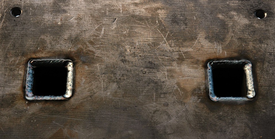

Managed to grab a few pics today - the first one is of the base (15mm plate) and two 40mm x 4mm wall box section uprights, with 10mm holes laser cut at intervals of 20mm. Looking chunky...
Next pic is a close up of the welding on the top of the base plate that secures the uprights to the base:
And the last one is a shot of the welding on the underside of the base plate. So the uprights are welded top and bottom of the base plate. I think that should be strong enough...

#6 Post by wayno » Fri Feb 20, 2015 8:33 am
I just saw your pics, glad to see you posted the uprights through the base and welded from the underside too, far too many people drop parts on top with a single weld and wonder why they break.
Nice looking bits of kit, can't wait to see the finished article.

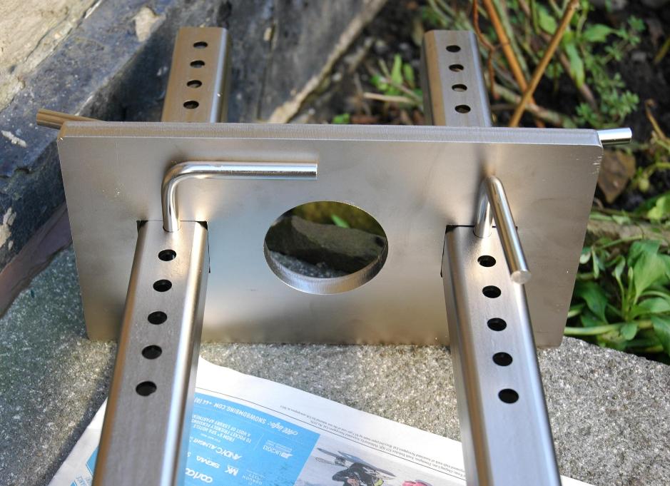

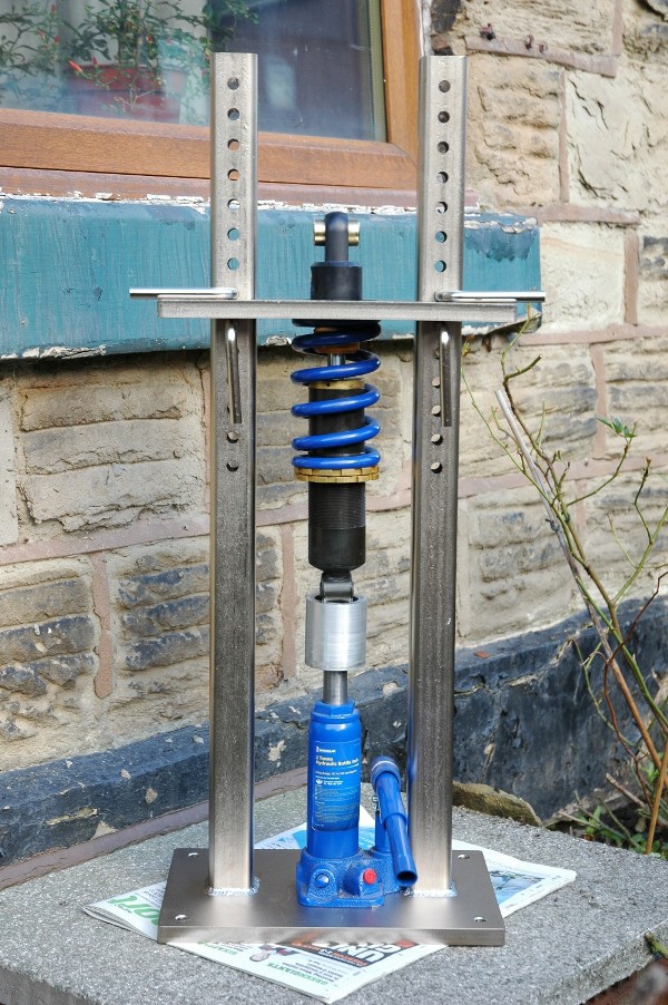

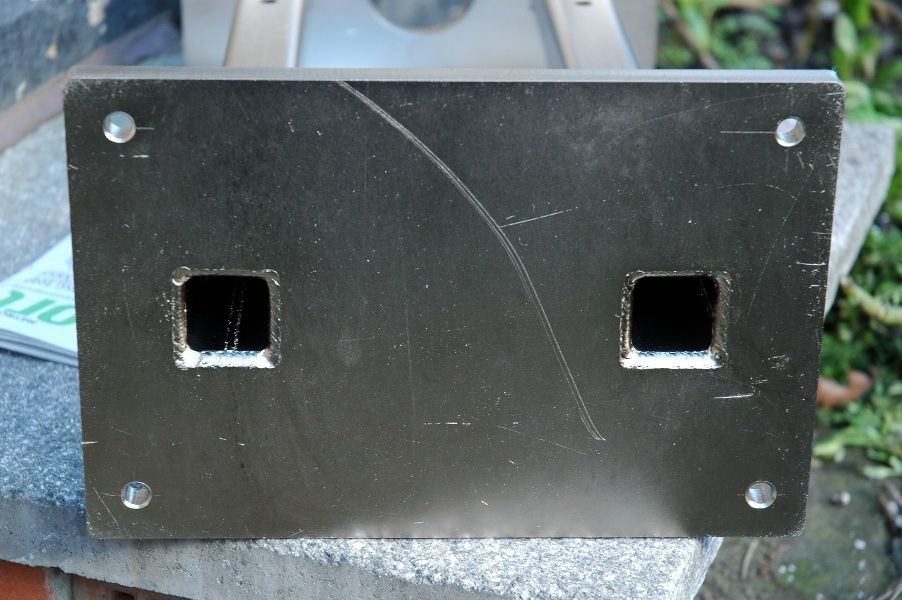

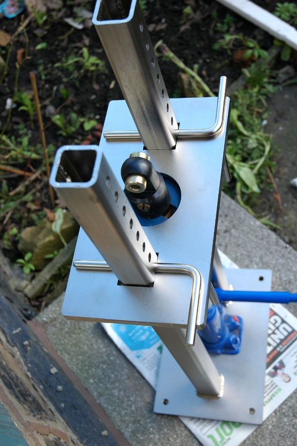

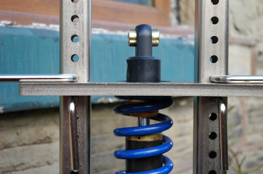

#7 Post by mangocrazy » Sun Feb 22, 2015 5:35 pm
Finally got a break in the weather on Saturday and managed to grab a few pics. First of all an overall view of the device, being modelled by everyone's favourite - A blue spring Sachs shock. This one has only done about 300 miles since new and that was 300 miles too far...
Next up is a view looking down on the top plate and upper fixing pegs:
Then a view from the side of the top plate, showing upper and lower fixing pegs:
Then an up-skirt shot of the top plate showing the lower fixing pegs.
And then finally a view of the underside of the base plate:
I'm well pleased with the results - I just hope some people are interested enough to put their hands in their pockets for one, or else I'll have a lot of expensive can-crushers lying around the house.... I think the electroless nickel coating really sets the whole thing off.
As you can imagine, with 15mm plate top and bottom and 40x40x4 box section uprights, they weigh a bloody ton. But then they are built like a brick sh1t house...
